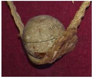

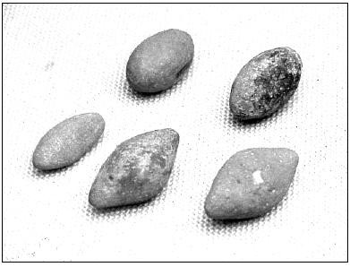

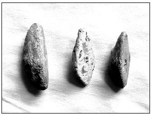

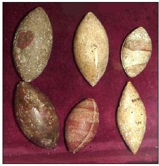

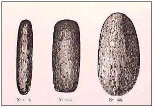

The first sling projectiles were of stone, not worked, chosen simply for their more or less spherical shape. Projectiles of natural stone were always used, throughout the entire history of the sling and in its different uses, including war. According to written sources, the Balearics used large ones, weighing a “mina” (436 grams), and the Persians used fist-size stones. And the Romans used them again later for economic reasons, in place of lead. The shepherds would always and exclusively use them, as is evident. But in war, the need for greater accuracy and range, as well as greater control and shooting speed would, in many eras, give way to a more or less standardized production of projectiles. Having projectiles of the same shape and weight would have the advantage of not having to compensate with each shot as a function of weight or shape, which would translate into more automatic and faster shooting, as well as greater accuracy. These same requirements for accuracy would also lead to the adoption of optimum designs in terms of their ballistic properties, and as a result, to the development of specific shapes that are not available in nature, or very difficult to find. In different eras, stones have been worked or retouched into spherical, ovoid, and biconical shapes of varied design. The first recorded projectiles are of stone, spherical in shape, corresponding to the year 6,000 B.C. Later, the ovoids would appear. In Sardinia, corresponding to the nineteenth century B.C., a series of small projectiles have been recorded, of obsidian, olive- or acorn-shaped. Their size is about 3 x 1.5 cm, with a polished surface. Corresponding to the “Nuragic” period, the appearance of rough stone projectiles is common, spherical and of a weight somewhat less than 500 grams, giving evidence of the frequent conflicts among these settlements of the Bronze Age (1). At times, the interpretation of certain stone objects, such as these sling projectiles, is doubtful, even though their size and design would be appropriate for such a use. This is the case, as mentioned in the chapter, “Ancient History,” with the carefully-made projectiles found by Schielemann in the excavations of Troy. Made in hard stone (diorites, hematites), they display quite varied shapes and are carefully polished. The size of the largest one included here is 5 x 2.8 cm, which, in a ferric mineral such as hematite, would provide weights and ballistic properties that are excellent for projectiles (2). ![]() Alleged Sling Projectiles of Troy Similar specimens in ferric materials have been found in other places, and in any case, the idea of their being interpreted as sling projectiles should not be dismissed, despite how unnecessary their costly production. We find equally careful workmanship in the Pacific islands or in medieval projectiles of our country [Spain], not to mention the reference by Guamán Poma de Ayala of the use of gold projectiles by the Inca kings. There can be no doubt that, in all of these cases, they were treated as objects of no ordinary use. The high quality projectiles of the Pacific are usually done in hard stone, such as basalt. Their shapes are biconical, broad and usually well-pointed, such as these that are lemon-shaped and of Micronesian origin. ![]() Sling Projectiles, Micronesia, National Ethnological Museum [Madrid] During the Middle Ages, the projectiles were of stone, usually selected cobblestones and, in a few cases, true projectiles of careful manufacture, such as those preserved in the Spanish Muséo del Ejército (Army Museum). The size varies between 5 and 7 cm in length. Notice the perfect size for the form of application, or olive-shape, and even the beauty of the material. Two of them have a striation or groove along the longitudinal plane. ![]() Medieval Sling Projectiles, Army Museum [Madrid] The invention of ceramic in the Neolithic, in conjunction with the appearance for the first time of organized warfare, offered the opportunity for mass production of projectiles. The first fire-hardened clay projectiles appeared in Iraq around 5,000 B.C. The first shapes were spherical but immediately went over to the more accurate oval and spindle shapes. One must also emphasize the frequency with which the clay projectiles were not baked but simply dried or hardened in the sun. In addition to simplifying production, without neglecting to provide sufficient strength for an effective impact, this had the added value of endowing the projectiles with greater weight by not completely eliminating the moisture of the clay, as occurs in the firing process. The weight to volume relationship was also increased this way, which is a decisive parameter for good range. For the same weight, the lesser volume reduces the air friction in flight, permitting longer reach. Thousands of clay projectiles have been found throughout the Middle East, corresponding to this period, and equally in many other places and periods, such as in North Africa, Sicily, Sardinia, etc. Above all, they were used by the Carthaginians, who were perhaps the ones who spread this type of projectile throughout the nearby Mediterranean. Thus we find them also in Roman archaeological beds, and even the Gauls used the incendiary projectile of fired clay. Their shapes were varied, from spherical (fairly rare) to ovoids, biconicals, spindle-shaped, etc. Their size, being variable, could be placed in average terms around 4.5 x 3 cm and weighing around 35 grams. To mention a typical bed of these projectiles, the excavations and ruins of Carthage have brought up thousands of clay projectiles, used in the defense of the city against the Roman attack.

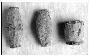

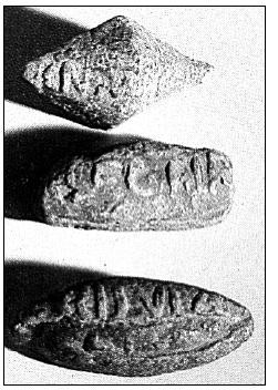

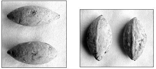

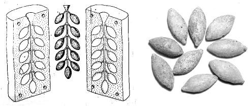

Although they are curiously small, the average dimensions might be about 5 x 2.5 cm. ![]() Clay Projectiles of Numancia, National Archaeological Museum However, the most spectacular progress in the production of projectiles would come with the use of metal. It seems that initially bronze projectiles were used – in Greece – but not as a common practice (4). The definitive step would come with the use of lead, which would also be introduced in a general way by the Greeks around the fifth century B.C., although we have already seen isolated records of lead projectiles in Minoic Crete, to which must be added the projectiles found in Italy, in Veii, belonging to the eighth century B.C. and the Villanovan culture. These isolated records give evidence of the experimentation or advance introduction of this weapon in very early times (5). Lead offers projectiles the maximum possible density, with a very much reduced volume for their usual weight, for which friction with the air is greatly reduced permitting their reaching great distances. The low melt temperature of lead allowed the ease of multiple production in ceramic gang molds. ![]() Mold and Lead Projectiles The small size of the projectiles and their speed made them invisible in the throw, which combined with its high power of impact and penetration turned the sling into a fearsome weapon, more damaging than the bow. Onasandro, in his book of the first century A.D., Strategikos, described it this way: The sling in the most deadly weapon used by the light troops because the lead is the same color as the air and invisible in its trajectory, such that it falls unexpected upon the unprotected bodies of the enemy, and not only is its impact violent in itself, but the projectile, heated in its friction with the air, even penetrates deeply in such a way that it disappears beneath the flesh as the swelling quickly encloses it. The biconical, tapered, and similar shapes quickly prevailed, just as in the clay projectiles which had demonstrated advantages over the spherical forms. In fact, ballistic studies have demonstrated, by means of calculation, what the ancients observed by experience. The ideal projectile would be fusiform (spindle-shaped), but somewhat flattened, which is to say of an elliptical cross-section rather than circular. The most common weights ranged between 20 and 100 grams, the average weight being about 40 grams. In terms of the average size, it varied around 4 x 2 cm. The Achaean slingers, mercenaries in the service of Rome, would introduce lead to the Roman armies at the beginning of the second century B.C. There are no great differences between the Greek and Roman bullets in terms of design. Those of the Romans, frequently called glandes (glans = acorn) for their similarity to this nut, are perhaps a bit longer and less regular. The differences lie in the emblems and inscriptions that at times they bear in relief. The two projectiles shown below are Greek, one inscribed and the other with a bucranium, head of a bull often used as a decorative architectural element. ![]()

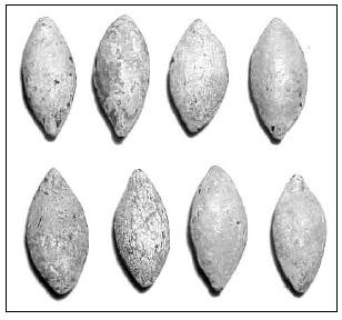

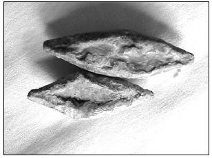

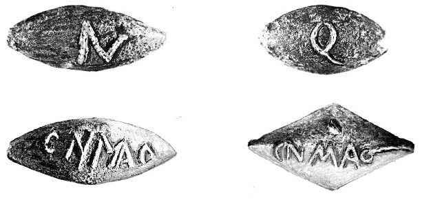

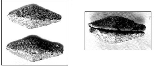

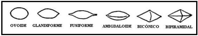

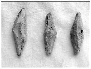

Thus, we could classify the forms in the following way, which does not exclude intermediate and atypical forms: OVOIDS: the greater cross-section more or less elliptical and the lesser cross-section circular. GLANDIFORMS: rightly called glandes, in the shape of an acorn, the lesser cross-section circular or somewhat elliptical. Points slightly sharp. FUSIFORMS: in the shape as used, sharp points and fairly elongated; cross-section circular or almost circular. AMYGDALOIDS: almond shaped; a flattened glandiform, of clearly elliptical cross-section; usually has a perimetric edge along the longitudinal axis. BICONICALS: formed by the union of two cones at the base. They usually have edges. BIPYRAMIDALS: union of two tetrahedrons at the base, bearing marked edges. ![]() One must mention the relatively frequent appearance of SEMIFORMS, which is to say, of half projectiles which are intentional and not accidents in the filling of the mold. The half is along a longitudinal plane, forming a flat base which is seated in the pouch of the sling, providing a good fit during the whirl and throw. Thus, projectiles appear that are SEMIOVOIDS, SEMIPYRAMIDALS, etc. In the picture [below] are two fusiform projectiles, one with the image of a spider. They are typically elongated and sharp-pointed, with lateral edges in two planes and a cross-section that is almost diamond-shaped, which would also aim for tearing. Their ballistic characteristics are optimal. ![]() The projectiles of the first picture [below left] are glandiforms, acorn type, with a perfectly circular cross-section. The amygdaloids of the second picture [below right], of elliptical cross-section, often have four longitudinal edges in the transverse planes; standing out are those of the wider section. ![]() The Iberians and Celtiberians also produced lead projectiles, being similar to the Roman types of that time but lacking inscriptions. The Iberian projectiles often show an irregular appearance due to a treatment after molding, a hammering, many times due to: correcting a defective molding; the reusing of projectiles; or obtaining special ballistic or impact effects according to the tastes of the particular slinger. In Ibiza, a large quantity of lead projectiles have been found from the Carthaginian period, perhaps due to the existence of mines for this metal and the requirements of the Punic Wars. The biconical bullets [below] were sometimes retouched with a hammer or were cut with a knife, giving a sort of polyhedrical faceting that delivered a more aggressive impact. ![]() At other times, only one half was reduced to displace the center of gravity towards the opposite point, making the cut point like a tail and the impact to come from the other side [below]. ![]() On occasion, and at the expense of their ballistic qualities, the points were crushed to achieve a more erratic movement and a very destructive effect [below]. ![]() With some frequency, the projectiles are not from molds, being produced by hammering a piece of lead, which at times might be a used and damaged projectile [below]. ![]() In contrast, there are occasions in which the projectiles appear in the archaeological beds in perfect condition, together in good numbers without having been used, as if just out of the mold [pictured below]. It is very possible that glandes were sometimes used for commercial exchange, as were arrowheads in times before coinage. ![]() In the molds in which the projectiles were arranged horizontally, the last in the series was at times not filled out completely. This resulted in a half projectile which might possibly be used, given the good qualities for accuracy of this kind when shot with the sling. Many other times, the production of half projectiles was intentional. The flat face would be placed supported in the pouch of the sling, providing a good grip and transmission of shot momentum on its edges. Stone projectiles found at random, when they have a flat face and are placed in this way, give excellent performance. The projectile on the left of the following photo, whose filling was more than half, would possibly be used in this way. The other two, were perhaps used for throwing together, thus achieving a double impact. ![]() The bi-pyramidal projectiles in the following picture, made by filling just to the middle, suggest the intentional molding of the projectiles for that specific purpose [of throwing together]. ![]() At other times, the edges of the incomplete projectiles were crushed to give them a more or less regular shape for conventional use, as in the figure below. ![]() But what is undoubtedly of great interest, of an epigraphic kind [inscriptions] and even psychological, are the projectiles with legends and marks or emblems. In the picture [below], one sees different inscribed Roman projectiles. Their shapes are also interesting. The first, biconical with edges in the longitudinal cross-section, is fairly common; the edges and sharp points would have a tearing effect upon impact as the bullet is turning. The third, shaped like a roll of bread, is amygdaloid with edges trimmed or flattened; it has a fairly flat cross-section. The cushion-shaped one in the middle is unusual. ![]() The inscriptions were often abbreviated, and some are even hard to interpret. At other times, by an error of the mold, it is written in a direct way such that the text appears inverted in the lead, in mirror image. The emblems usually represent the city, as with the coins (horse, star, palm tree, etc.) or the deadly qualities of the projectile, as with an eagle, winged rays, serpent, spider, scorpion, bee, dagger, spearhead, trident, etc. ![]() The inscriptions could be the number or anagram of the people at war, the name of the general of the army, the name of the legion, the name of the head of the corps of slingers, etc. ![]() These last two [above] represent the name of Gnaeus Pompey Magnus [Pompey the Great], who fought against Sertorius in Spain in 73 B.C. Other inscriptions are invocations to the gods, or recommendations to the projectile and the slinger, such as “shoot with accuracy,” “give yourself speed,” “strike,” “hurt Pompey,” “place yourself well” – which is what the one on the left says [below] - etc. Others are sentences, such as “death to the fugitives” or “resistance completely destroys you,” and, finally, others are mocking expressions, such as “candy,” “take it,” “break the teeth,” “eat it,” “a bad present,” “labor pains,” “this is a candy,” “take this,” – which the one on the right says – etc. ![]() Despite the excellence of the lead projectiles, in the Imperial period, it appears that they stopped using them or at least did not continue on a widespread basis, perhaps for economic reasons. On Trajan’s Column, just as in the texts of Vegetius, there only appear references to stone projectiles. These stone projectiles shown on the Column are of a large size, as also were those that some slingers used, such as the Balearics. Diodorus mentioned the Balearic projectiles saying that they weighted a mina. There are several estimates of the weight equivalent to the Greek mina, varying between about 350 and 450 grams, which taking the lesser of these values would give us a projectile similar in size to a tennis ball. Xenophon, in the Anabasis, said that the Persians were using projectiles the size of a fist and we saw that Oviedo, with regard to the Incas, related that they threw stones worked by hand in the size and shape of eggs. The stone projectiles must always have been used, possibly coexisting with those of lead, their use being different. Those of lead had great range and could penetrate the body of the enemy, while those of stone were impact projectiles, to crush the enemy at a medium distance, causing serious lesions even through armor, by denting it. In conclusion, placing ourselves in more recent times, one sees in this photo [below] a kind of round projectile that is also of stone and well worked. The sling is of hemp, in a simple three-string braid and reinforced with leather in the pouch. It is a recreation of a medieval sling made in the nineteenth century. ![]() Spherical Projectile, Army Museum Well-selected projectiles, or with minimal working, fulfilled their function perfectly until the latest times.
