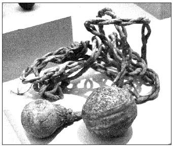

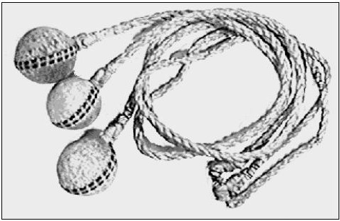

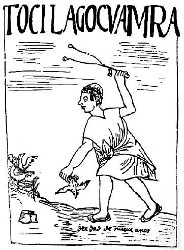

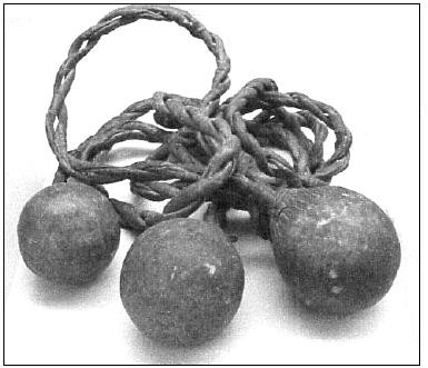

Because of their similarity and relationship to the sling, it was inevitable to address four weapons, three of which have also survived a long time. One of them, the boleadora, is its ancestor; another, the staff sling, or fustibalus, is perhaps as old or even older than the sling; the kestrosphendone, a sling for launching arrows, is a special design which survived only a short time; and finally the tribulus or caltrop launcher, a sling adapted for throwing special projectiles against cavalry, was used, like the fustibalus, until the Middle Ages. We have already seen the very ancient origin of this instrument in the chapter, “Prehistory.” The evolution that was noted there was from a “ball on a cord” to a boleadora of several weights, and it seems likely that it passed through a phase of first being equipped with a handle. ![]() Boleadora with Small Wooden Weight, Museo de América [Madrid] There is a fact that at the same time supports this theory, and it is the existence of boleadoras of two weights in which the main one is of stone and the other is of wood and smaller, making it serve as a handle in the throw. The evolution from initially a small, conventional handle to this optimized form, which also better fulfilled its role of entangling the prey, seems more than likely. A typical boleadora has three weights, one of which is smaller than the others, even when being of the same material, so as to assume the function of a handle in the whirling. The boleadora is a hunting weapon which requires great ability for a proper throw. It wraps itself with remarkable effectiveness in the feet of animals, hindering them, and making them fall to the ground. ![]() Boleadora of Three Weights and a Leather Braid, Museo de América They have been used from prehistoric all the way to modern times, in which it barely survives among the famous Argentine gauchos, more as folklore than anything else. They were widely used in the previous century [19h] and the beginning of this one [20th], when they were an indispensable tool in the capture of livestock for marking them, etc. The boleadora appears in many prehistoric cultures during the Middle and Upper Acheulean periods and lasted up to the Protohistoric in some places. The remains that are found are obviously the familiar “bolas,” of well worked stone, of an average diameter of about 8 cm [3.1 inches] and which at times appear in groups of three. In more recent times, the Eskimos have used boleadoras and above all, the different South American peoples, as in Argentina, Chile, Uruguay, southern Brazil, and the plateaus of the Andes. It is a hunting weapon of the plains, suitable for capturing large herbivores. ![]() Eskimo Boleadora, Early 20th C. Length open: ~185cm [72 inches]; weight 635 grams The Eskimos of North America, among others, have also used a variety of the boleadora of many small weights (up to eight) for the hunting of migratory birds, such as ducks and geese, which in large groups offered a good opportunity to be caught by the linking of their wings. ![]() Amateur’s Boleadora with Lead Weights for Hunting Birds The effective range of this boleadora might be about 35 meters. This application also existed, for example, in Peru, in Pre-Columbian times, as captured in the lovely drawings of Poma de Ayala. The image [below] reflects the activities of the boys of 9-12 years of age, among which was the hunting of birds, with whose feathers they would decorate their weapons, shields, and clothing. Pictured, we see a boleadora of two weights with a handle. ![]()

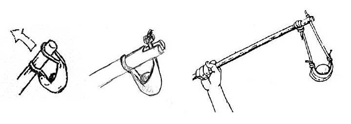

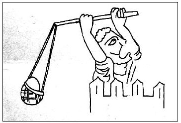

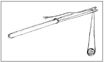

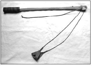

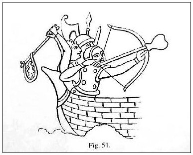

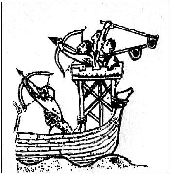

The staff sling or fustibalus [also fustibal], whose suspected antiquity we have already seen in the “Prehistory” chapter, is clearly documented in the Roman era. It is a sling adapted to the launching of large stones, equipped with a shaft or handle of different dimensions which, in the larger sizes, must be held with both hands. The throw is made by propelling the staff sling from back to front in a single movement. Different people used it even before the Romans, and most of all in the Middle Ages, it was a common weapon in sieges and naval battles. There are different designs of the weapon, all of them having in common a long handle or shaft to which is tied one of the cords of the sling. The other cord is attached to the shaft with a loose fitting, well-controlled by the hand, as in the conventional sling, or in an automatic way by the impulsion of the shot. In the second case, the cords of the sling are very short, fastened at the end of the shaft. The first type relates to a conventional sling in which the release cord is longer, passing through a hole or fork at the end of the shaft and then down to the hand. This would be a very ancient design, probably used in prehistoric times. In addition to its power and control, almost comparable to the conventional sling, it had the advantage of not requiring a whirl, which would make it especially useful for hunting. ![]() Recreation of a Staff Sling In terms of the second type, the only one documented, the method of automatic release could be a simple cord that slipped off the end of the shaft [below left], a knot in the cord that fit into a slot of the shaft [below middle and right], etc. ![]() Common Staff Sling

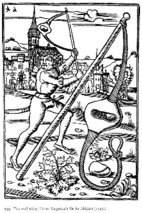

The exact design that they used is not completely clear in the documentary Roman sources, the best being the description of the weapon provided by Vegetius, which is nevertheless somewhat confusing: The staff slingers are those who launch stones with the staff sling. The staff sling is a long stick, of four feet, to which is joined in the middle part a leather sling and which, impelled with both hands, throws stones in a similar way to a catapult (1). If the length and manner of launching the instrument is made clear, what one does not understand is the method of tying the sling in the middle of the staff, although a few interpretations, such as the one in this sixteenth century engraving, refer to a distal tying of the sling and the central holding of the other cord with the hand. The drawing is also fairly confusing in that the release cord’s termination in a loop seems to correspond to the distal fastening of the same cord, in contradiction to the drawing of the staff slinger. There appear to be no advantages to this hypothetical type of adaptation as compared with the staff slings illustrated by Leonardo [da Vinci], of long cords, both located at the far end, which add more power to the shot as compared to the common staff sling. The Arabs seem to have also used this staff sling of long cords, as we will see in a later drawing. ![]() An interpretation of the text of Vegetius does fit in the line of staff slings, in the supposed prehistoric form shown at the beginning. The fixed cord would be tied in the middle of the staff and the release cord would also end there, held by the hand that moves forward. Both cords would pass through a slot or fork at the far end of the staff. After experimenting with this design, I have observed the following qualities: - Good control of the release, governed by the hand, as in the prehistoric staff sling. - Ease of loading and setting up the sling, similar to the conventional sling. One simply has to eventually bring the cords to the fork (2). ![]() Vegetius also described the placement of the staff slingers in the order of battle of the Roman legion, beside the slingers and crossbowmen. In the Middle Ages, we have many true depictions of the staff sling. They appear in the rich illustrations of the European manuscripts of that time. The following drawing, portraying a naval battle, belongs to a manuscript of the thirteenth century preserved at Benet College, of Cambridge [University]. One sees the use of an incendiary projectile, exceedingly damaging in this type of combat. ![]() Naval Combat, Illustration from a Manuscript In this other one, from a manuscript preserved at the Bodleian Library (England), typical projectiles are used, but the attack seems to be directed against a coastal fortification, as suggested by the angle of the shots. ![]() Bodleian Library Manuscript, Naval Combat In Spain, they were also commonly used. We saw them appear in the chapter, “The Middle Ages,” among the weapons mentioned by Alfonso X in “Las Partidas.” And the Moslems also used them widely. Below is a detail from a fresco concerning the conquest of Mallorca in the thirteenth century by James I [Jaime I] of Aragon, in which a warrior is seen defending a Moslem fortress. ![]() Moslem with Staff Sling, Museum of Catalan Art [Barcelona] In the notes or designs of Leonardo da Vinci concerning ancient weapons, which we have already seen in “The Renaissance” chapter included some large size staff slings. In the fifteenth century, the use of this weapon was very widespread, in its two versions - for one or two hands. It is thus evident that the sketches of Leonardo are true to reality. The type of fastening that he shows is based on a hole through which the fixed cord passes, which ends in a knot that holds it at the hole. The release cord is held in a distal slot. At times, large rocks were thrown with staff slings as seems to be shown in this fresco of the castle of Issogne in Italy (3), where an array of the castle’s medieval weapons are shown. ![]()

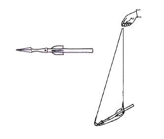

The kestrophendone was a special sling adapted for the launching of arrows or short darts. It was invented by the Greeks, who showed the Romans how deadly their weapon was in the Macedonian Wars. It was a supremely effective weapon, joining the impact power and range of the sling with the capacity for penetration of the arrow. Arrows could not exceed a certain weight, limited by the manageable draw weight of the bow and an acceptable range. The power developed by the whirl of the sling was superior, and the weight which could be thrown to a distance equivalent to the bow was at least ten times greater. Thus, with this new device, arrows ten times heavier could be thrown, achieving an impact so powerful as to cut through the body of an enemy and inflict great damage. In addition to the kestrosphendone appearing in a few rare drawings on Grecian urns, we have the good fortune of its having been described by two classical authors, Polybius and Titus Livius. In his Histories, Polybius said: The so-called kestros was an invention which was first seen in the Persian War. The shape of the projectile was as follows: it was two palms [palmas] long, and the tube was of the same length as the point. The first had a wooden shaft fitted of a palm in length, the thickness of a finger, in the middle of which there were three fins firmly implanted and fairly short. The cords of the sling from which the projectile was shot did not measure the same, and it was inserted in the curve of them in such a way that it would be easily released. Thus, when the contraption was whirled, while the cords remained tense, the projectile remained immobile, but when upon making the shot, a string was released, the shot, launched by the cord, left in the same way as a lead bullet leaves a sling. The impact was very violent and if it hit someone, he was seriously wounded. In turn, Titus Livius, two centuries later, would take the explanation of Polybius and transcribe it this way, when speaking of this war in his History of Rome: This new type of offensive weapon was invented in that war. A point of two hand spans [palmos] was affixed to a shaft of half an elbow in length, the thickness of a finger; around it were fitted three small fins of spruce, as they used to do with arrows; the sling had two unequal cords in the center; when the slinger made it whirl forcefully with the projectile in balance, it shot out, buzzing like a lead bullet. When half the soldiers had been reached, and now exhausted could not even easily hold their weapons…. The uncertainty that the transcription presents and the corruption of a few words of the original manuscripts (Greek and Latin) lead to a different meaning of the words that express measurements in the original language, and in the translation, they introduce a certain chaos into the different interpretations which the different translators make of the design of the kestros. Thus, the terms palmas and palmos appear at times, the last being a transverse measurement of the hand. The term scutalia, which we saw in the description of the Achaean sling, appears again in Titus Livius, often being translated as “cords of the sling.” The interpretation that we give, then, as an “element for holding the projectile, '' in abstract terms, covers the full meaning of the kestros having two different elements for holding, as we will see in a moment. Attempting to clarify the subject in the book Dictionnaire des Antiquités Grecques e Romaines (1892) [A Dictionary of Greek and Roman Antiquities], overseen by Daremberg and Saglio, the instrument is described, arriving at the following conclusions: - The iron point of the kestros is of two “Roman hand spans,” which is to say a total of 15 cm long, being equal the point itself and the iron part in the form of a tube for inserting the wooden shaft. - The shaft was a half a “Roman elbow” in length, equivalent to 22.5 cm and the width of a finger. - The fins were very small and rigid, and were located in the middle of the shaft. - The two cords of the sling were of different lengths, and one of them had a device for holding the free end of the fins of the dart, and which did not move during the whirl but would allow it to be freed in the shot. In our opinion, the aforementioned inequality of the cords is supported in a mad translation of the text of Titus Livius, which really refers to the sling having two pouches or different elements of holding the projectile (scutalia). The kestrosphendone would thus be as the following figure shows. Noticeable are a small conventional pouch, designed to hold the point of the dart, and the other formed by two cords for inserting the tail of the dart and which is not moved in the whirl. ![]() It is also said in the Dictionnaire that a certain M. Alexandre Bertrand carried out an experiment with the weapon in 1874, building a prototype according to the description of Polybius. The design that he used is depicted in the drawing [below], in which one sees the position of the fins as considerably forward, at the approximate midpoint of the dart. Though not clearly seen, the interpretation that he makes in the drawing is indeed correct of the existence of the two small pouches or means for holding the projectile. ![]() Bertrand assures that, after much experience, the need for the different length of the sling cords was confirmed, and also that this difference must be such that the angle formed by the dart with the ground is about 39 degrees. It seems that a brother of his came to the same conclusions by means of calculation. We see that the unequal length of the cords, although not being described by Titus Livius, is a consequence of the apparently necessary incline of the dart. Having personally achieved different, unsuccessful experiences with Bertrand’s design, I have finally arrived, after modifying it, at different conclusions which, if not correcting his theory, do in any case present an alternate and effective method of launching the dart. These conclusions are the following: - The problems of an angle as open between the cords and the sling as that of Bertrand is that in the whirling they entwine among themselves, making slinging impossible. The angle must be reduced as much as possible, avoiding a total closing which also produces entwining. An angle between the cords of around 15 degrees functions correctly. This equates to an angle of the dart with the ground of about 70 degrees, almost twice the one used by Bertrand, with the dart remaining fairly vertical, well prepared to take up its forward trajectory in the shot. - The position of the fins, as adopted by Bertrand, is centered on the dart, while Polybius describes them as centered on the shaft. The more rearward they are displaced, the more stable the dart’s flight. - Another important point to consider is that if the dart is pointed, as in reality it must be, at the moment of shooting, the point tends to stick in the small pouch upon which it is supported, ruining the launch. To avoid this, it is necessary to use some means of prevention, such as a small plate or coin either attached to the pouch or replacing it to support the point in such a way that it slips correctly upon throwing, freeing the pouch.

(1) Vegetius, Epitoma Rei Militari, III-24 (2) Actually, one can use a large conventional sling directly on the staff of the staff sling, holding the cords in the usual way and grasping the staff by its middle part with the hand that holds the cords. These are passed through the fork and, this way, without the need for whirling, one can throw large weights with a single movement - the typical cast with a fishing rod. (3) Fresco of the Castle of Issogne. See A. Frederici, Castello della val D’Aosta, Arsuna, Firenza, 1977. (4) Vegetius, Epitoma Rei Militari, III-24 (5) Included in, Historia orgánica de las Armas de Infantería y Caballería españolas. Conde de Clonard, 1851. [Òrganic History of the Weapons of Spanish Infantry and Cavalry by the Count of Clonard] (6) Williams, Reid, History of Weaponry. [possibly William Reid, Lore of Arms: A Concise History of Weaponry, 1984]
